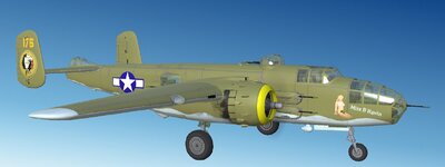

What I wanted to end up was the airplane called Miss B Havin which I thought would be pretty straightforward...
1) Change all of the sand / tan coloring to OD so the plane is all OD.
2) Change the ring on the engine cowls from red to flat yellow.
3) Change the emblems to a different USAAF style.
4) Change the nose art to Miss B Havin.
Your example gave me hope considering you did it fairly quickly but just my luck that I would pick an airplane that has an in-depth color scheme.
Someone spent a lot of time creating the original.
If you are willing to send me a PM, I would like to first understand how you changed the colors so quickly yet left the panel lines intact.
Do you want the Lady and the Miss B Havin text on both sides of the fuselage nose, or just one side like some of the pictures?
