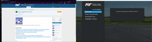

Hi i´m also new to realfight. I have Realflight evolution and wanted to download a plane from swap pages but if i dowload a EA plane I download a rfx file. In the import section in realflight they say you just can import 3D planes from FBX or Kex files so they dont show me my downloaded plane.
Any solution ?
