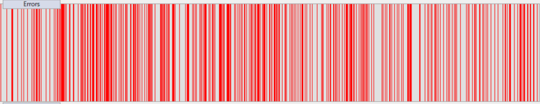

Here is an example capture on USB transfer between PC and InterlinkDX. InterlinkDX sent some data to PC, but it was not recognized by PC's USB controller chip. My PC's USB ports were pretty nervous...
If we use HUB between PC and InterlinkDX, number of error packets become less. But there are still many error packets. Here is an example view of error packets. I captured 1000 packets between HUB and Interlink DX. 391 packets had CRC errors.
