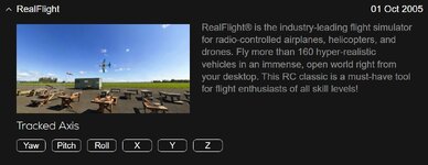

Thanks for the reply but I have to diagree with some of your points.
Website shows that it is supported. (see attached).
Also, if you search TrackerIR and Realflight there are several older posts in different forums where people were using it.
Additionally, when flyin a model, especially in Realflight, its handy to be able to glance over at the end of the runway and judge your aproach and hight above the spot where you want to touchdown.

Time to eat some crow - yes, I missed it in their software list.
And if not useful why are there quite a few people who are using VR headsets with RF?
Hello MidnightFlyer, I am having the same issue as you are with TrackIR, but the picture you included has a date in the top right corner of
01 Oct 2005. I don't know if you have RealFlight 9.5 or 9.5S still, but I just used TrackIR with that older version and it works fine. I started a separate conversation with Ryan also, and now I am waiting to hear back from him.
