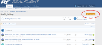

@ranger2bn - please start a new discussion about your issue, using the button circled in the attached picture. Posting here, at the end of a discussion about someone else's concern has two ill effects:
1. It is VERY unlikely your post will not be seen by those that can help you, since it is hidden within a different discussion.
2. It confuses the current discussion, as we are then trying to reply to two different people with likely two different problems and solutions.
In the course of helping you, we may refer you to posts such as above to give ideas on how to fix an issue. If you have found them on your own (like you did here), please let us know in your new post, so we don't repeat having you do things you have already tried.
Give as much detail as you can - what controller (An Interlink or a real transmitter (include brand and model), using a dongle or a wired connection, what version of Real Flight (Evolution, Trainer, or an older one), what kind of computer you are using (laptop/desktop and make/model). The more you can tell us about what you have, and specifics about what is not working - including error messages, if any - the better.
