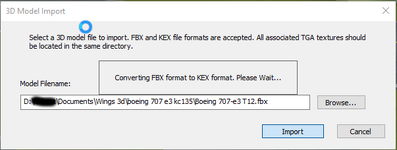

the best solution I have come up with for blender users is to use the newest non DX-11 Realflight (9.5s, 9, or 8) to generate the kex then import the KEX to evolution.
export the FBX from blender and run it throught the autodesk FBX converter to make it into an ascii file.
open an older RF 8-9.5s
run through the normal fbx import process until you see
or at least what is below. small files might move quickly past the first image
once you see select type of KEX you can cancel the import and close RF
open RF Evolution and import the KEX file (not the fbx) and continue the import process as normal.

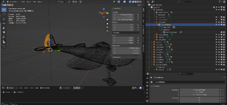

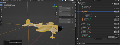

could you possibly post a few pics onto how this exactly goes in working
The rudder was having an issue where the normals were flipped in RF.
I created an Empty at the pivot point, with the correct orientation, and named that ~CS_MMR. I then made that the parent of the rudder object which you can see in the second picture and named that ~CS_MMRBody (that name doesn't really matter but I like to be consistent). You can also see the rudder object has a standard orientation.
Does make more sense? I'm happy to give you more detail, or clearer steps if you need anything!
