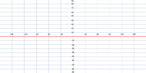

Well, in the meantime I did some tests and proceeded by trial and errors. I think I now understand how it works.
Here are my findings for anyone interested.
The panorama picture should be set according to this :
with height/width = 1/2 (180° / 360°)
I loaded this panorama into the game and this seems to work perfectly :
I then tested the alignment in X & Y to understand how it works.
X is a tilt of the panorama along an axis defined at 45° heading
Y is a tilt along an axis defined at -45° heading
This is confirmed here :
Test of -20° in X
Test of -20° in Y :
There is also an option to define the north
which results in -60° in heading as expected :
Finally I looked down at -90° :
We see that the tail of the plane is approximately at -50° which is what I would expect.
Hopefully it clarifies how the panorama should be projected before importing into realflight.
