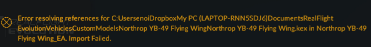

You can read the full message if you open the image.
I have not seen any error like than before, are you tring to import it straight from dropbox. I am wondering if it has to do with how long the file name + file directory is that used to be an issue a few years ago not sure if it still is. I would try saving a local copy then importing from the local copy and not dropbox
ok.
Sadly, after many attempts I've had no positive results, this is the first time it happened after using many of your models.
yeah you are running into the bug
it was sort of patched in 10.00.72 while it no longer crashes it cannot import file that are longer than 143-ish characters. and with the name of your pc with the dropbox I count about 150-155 characters
